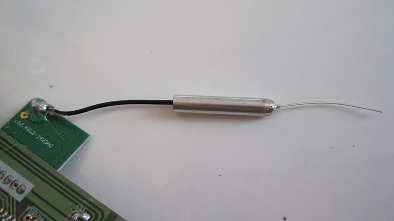

    I'm thoroughly convinced the new transmitters we received fix the 'mass dropout' problems. When I sent samples of the old TX design to a customer who just happens to work for a company that makes bluetooth devices, they stated the brunt of the problem was the mismatched coax impedance on the TX module. Their findings make sense as the improved folded dipole antennas we received on our V252 and V262 transmitters have a shorter black coax mated to a folded dipole:
    No one who has reported to have received 'fixed' remotes from Banggood (the only other vendor than us to even admit there was a problem) has shown this new folded dipole design antenna on the units they received.
    I'm convinced that the new folded dipole antennas along with trimming your RX antennas to 31mm (as measured from the solder joint on the other side of the PCB) fixes the majority of dropouts. You obviously don't have to trim the antenna on V252s as they use a printed PCB antenna.
