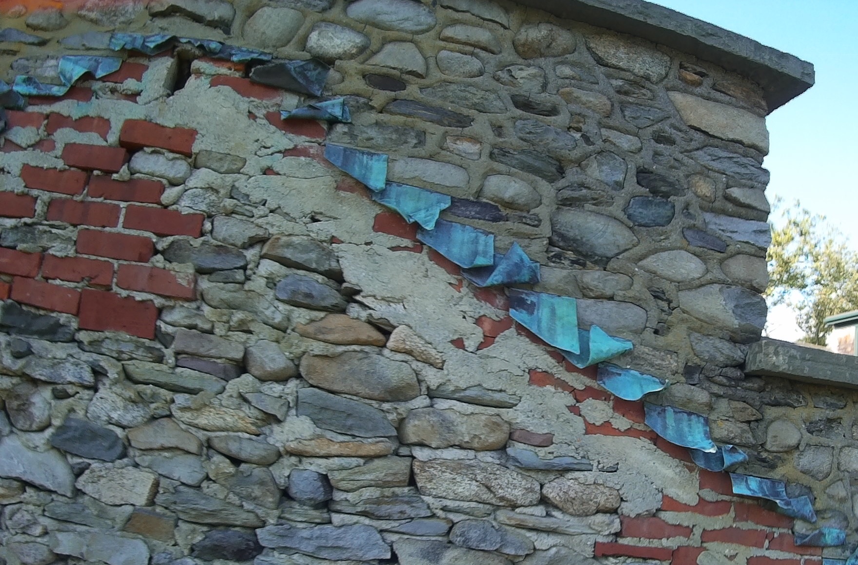

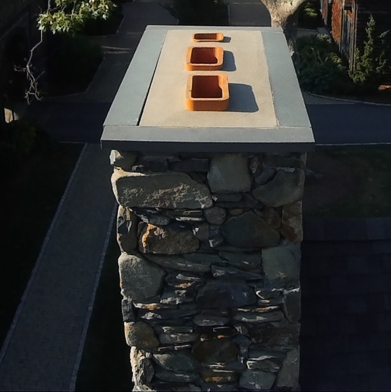

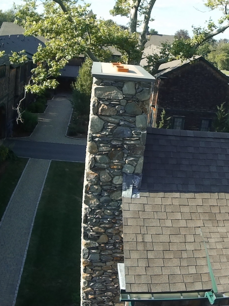

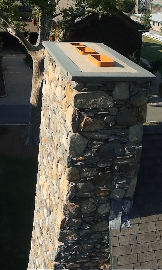

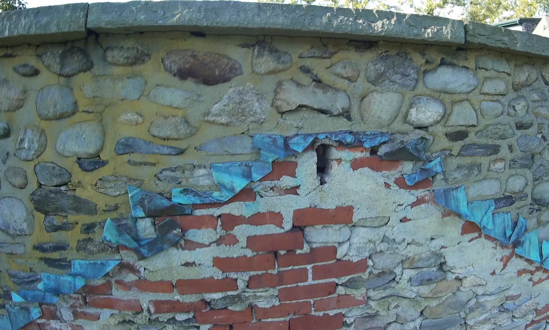

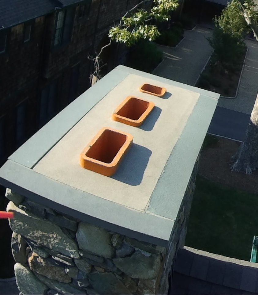

    To celebrate, here are some quickie pics of a chimney and a stone wall - taken on an extremely windy day without FPV and with an $80 camera (Mobius)......

    So the photos that Craig showed above this comment are about what I would like to get. I am not sure the whole idea about a "sled" is really necessary, and the inspection of chimney liners isn't something I think I need to do. (or would want to do) I may want closer up photos of flashings, tuckpointing issues, etc.
