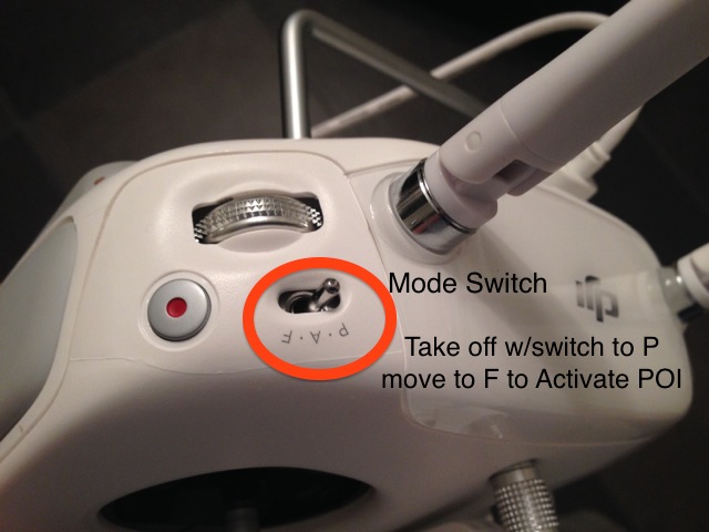

    2. Enable "Multiple Flight Modes" in the DJI Go App. This can be done once you get to the field or before - however, note that some settings don't take properly if the Phantom itself is not on and connected to the app.
    This setting is located under MC Settings --> Advanced Settings --->Enable Multiple Fight Mode
    Explanation - if Multiple Flight Mode is not on your Phantom 3 mode switch (the upper left 3-way switch on the Phantom Remote will not change the flight mode. That is, your Phantom will always be in P-GPS mode no matter what the setting).
    3. Since this is your first POI trial, pick a target in the middle of open ground and one which is not too tall. Assure you have an sd card in the Phantom- and turn on the Phantom in the usual manner with the 3-way mode switch to the usual (right hand) position P-GPS.
    Wait for full GPS and home point lock.
    Take off and let the Phantom hover at a safe height and distance away from the target.

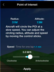

    4. Move the mode switch on the Remote to the leftmost position (Function Mode). The DJI Go app will show a menu of icons asking you which type of flight you wish to perform. Select POI (Point of Interest).
    5. The GO App will prompt you to fly to a point exactly above the center of your proposed POI shot. It's a good idea to have the camera facing down at this point so you can properly find the center. Once you have flown over the center hit the Apply button to set the POI Center Point.
    Screen Shot 2015-09-12 at 9.36.50 PM.png Screen Shot 2015-09-12 at 9.37.33 PM.png
    6. The App will now prompt you to move the Phantom away from the centerpoint to the outside of the circle (radius) you wish to circle the object at. It will also allow you to set the speed at which it will circle. Lastly, it may prompt you to confirm your RTH (Return to Home) altitude...of course you always want to set this higher than any obstacle - especially the Point of Interest!
    7. Press the Start button and the Phantom will undertake it's mission. Note that you control the gimbal tilt with your Remote. The Phantom will circle your object continually (more than once!) - it's very easy to abort or terminate your POI mission - just move the Remote Mode switch back to the right position OR - if you didn't hide the POI menu, click "Exit" and then OK.
