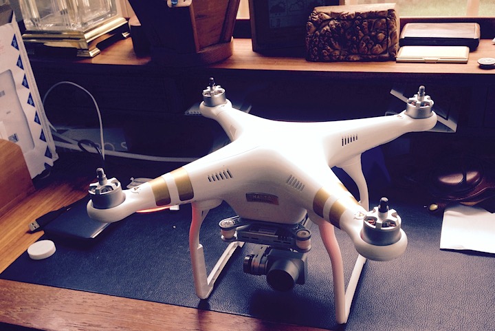

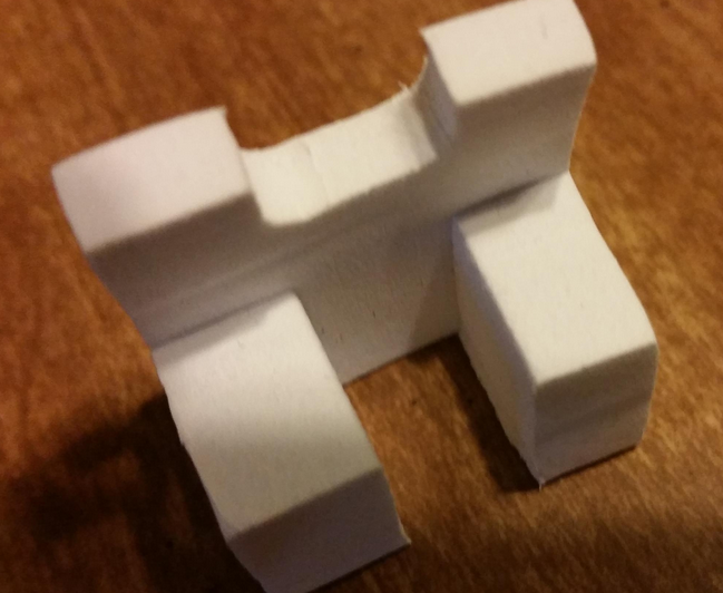

    1. There is a small piece of packing foam - white color - behind the gimbal. Many users have failed to remove it -resulting in very poor video. Remove this packing before use and toss it away or save it for when you ship or otherwise manhandle your P3.
    Foam Piece shown above....

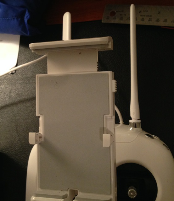

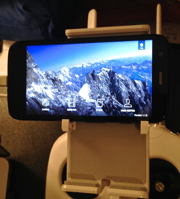

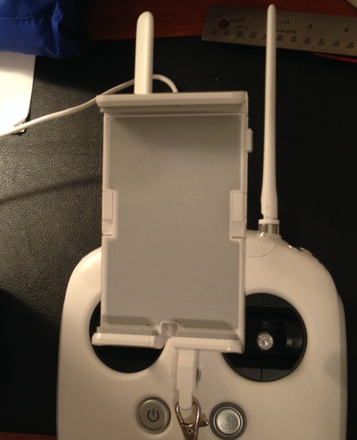

    2. The phone and/or tablet mount on the TX...can be confusing. It's set up stock for use with a large tablet and the quick start guide does not mention how to install a smaller phone in sideways in it!
    Easy Enough!
    A. At first glance the holder looks like it will only hold the phone in a vertical fashion.
    B. Press the tab on the upper right of the holder - the top of the holder will move upward.
    Flip out both of the tabs at the midpoint of the holder - they are braces to hold the bottom of the phone!
    C. Install your phone or very small tablet making sure that any buttons on the side are not pressed by the top or bottom brackets. In the case of my Moto android device, the buttons had to go down and the phone a bit off to the side as shown.

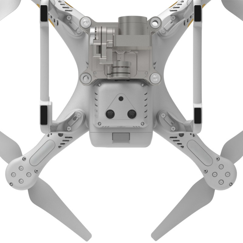

    Many early users have questions about how the VPS - Vision Positioning System works.
    This is an array of sonar (sound) sensors and a bottom facing camera.
    This system works as a "helper tool" when the Phantom is close to the ground or other surface - usually it self-activates when within about 3 meters (10 feet) of a solid surface. This means you could fly off the ground up to a flat roof 30 feet high - the VPS would be on for the first 10 feet as you get into the air, then it would turn off once you were over 10 feet high. Then, when you got to 35 feet or so and headed over the flat roof, it would sense the roof (5 feet below) and turn on again.
    It makes decisions in combination with the other instruments and sensors (GPS, Barometer, etc.) . It is not failsafe nor of a military or exacting grade. It will, for instance, help you follow the ground if you are a few feet up and following a road, driveway or path which is hilly.
    It also may help with indoor flight when GPS is not available.
    You are turn it off in the app if you prefer it to not be active.
    I AM TURNING MINE OFF BECAUSE I AM WORRIED ABOUT IT CAUSING PROBLEMS...I have no need for them since I am not flying inside, et.
    Pic of VPS (the 3 sensors in a triangle on lower part of Phantom 3 body - center of this pic) below:

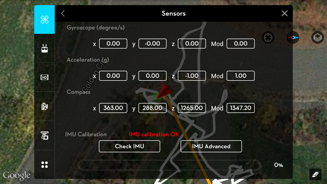

    Many Phantom 3 users have reported a tilt in the camera gimbal which results in the horizon not being level.
    This may be due to forces which the Phantom was subject to during shipping as well as additional sensitivity in the new F/C (Flight Controller).
    Here is the fix - an advanced IMU calibration.
    Set the Phantom 3 on a VERY level surface - perfectly level, like a kitchen countertop, the floor in a well built house, etc.
    Turn on the TX and then the Phantom and let it warm up.
    Hit the setting menu on the upper right side of the app screen - then the top left icon, which is MC (the Master Controller) --->Sensors-----> IMU Advanced
    Do the calibration - and all should be well afterwards.
    You may have to do this twice if it doesn't work perfectly the first time.
    Also, after you do this - do a gimbal calibration also from the settings ---> gimbal screen.

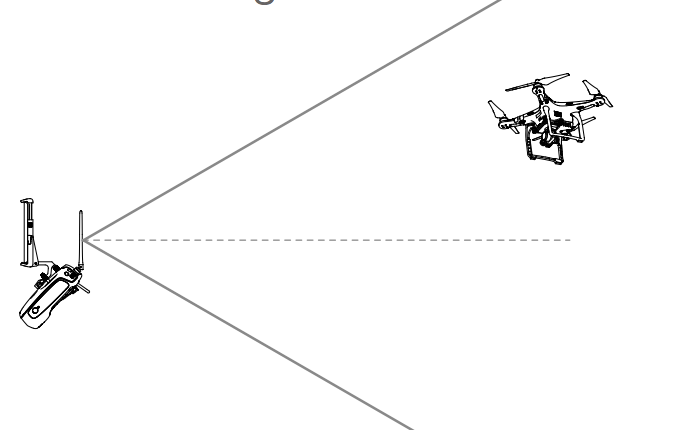

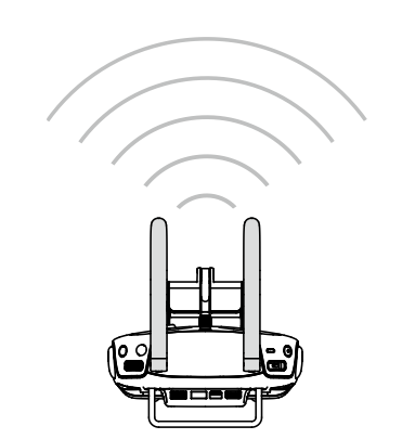

    Note regarding the antennas - even though they are blade shaped, there is no difference in terms of which way the wider (flatter) face or the narrow face is orientated.
    In addition, try to keep the two antennas vertical and on the end of the TX facing the Phantom.

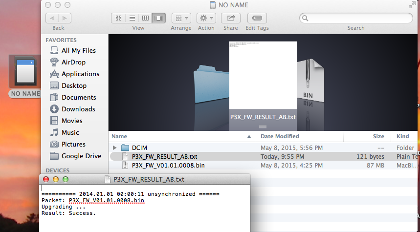

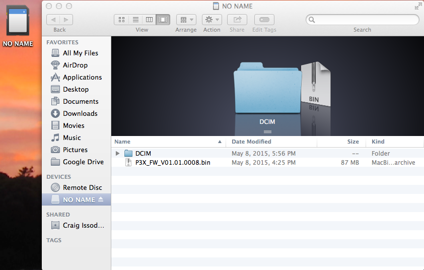

    1. Download onto your PC or Mac and UNZIP the newest firmware package from the DJI support pages:
    http://www.dji.com/product/phantom-3/download
    2. Remove the MicroSD card from the Phantom 3 Gimbal and place it in an adapter - insert into your computer in the usual fashion. Card should mount on your desktop - open and you will see a directory called DCIM.
    3. In the unzipped directory from DJI will be a single large file with a .bin extension. Drag this file onto your MicroSD card so that it looks like this:
    4. Unmount and remove the MicroSD card and put it back into the Phantom 3
    5. Turn your Phantom 3 Aircraft on by pushing the battery button in the usual fashion (one short push, then one longer push). The Phantom will come to life and prepare itself for the upgrade.
    You will hear a series of scratching sounds which the manual and firmware instructions describe as D-D-D-D - four short noises in a row repeating themselves. See video below. This indicates the firmware upgrade is underway. In about 8-10 minutes the noises will change indicating success of your upgrade.
    6. Turn off your Phantom 3 aircraft in the usual way. Remove the MicroSD card and put it back into the computer to check for success. There will be a new text file - open it and it will indicate success (or failure).
    Assuming success you should delete that text file (sucess message) from the card.

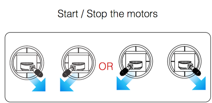

    The stick controls to arm or de-arm the motors have changed in the P3 from former models!
    Now only the following sequences are specified.
    These are called the "Combination Stick Command (CSC)" in former models.

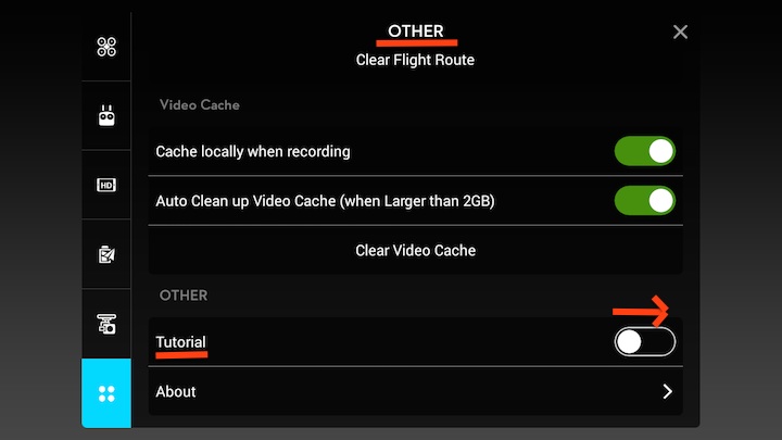

  13. webman

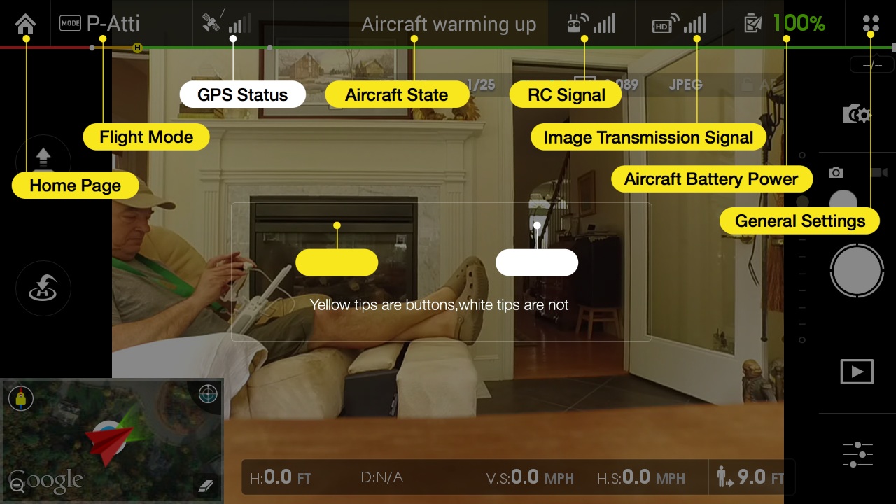

    The DJI Pilot App which run the Phantom 3 is not fully documented in any manual - you'll have to do some exploration to unlock various features.

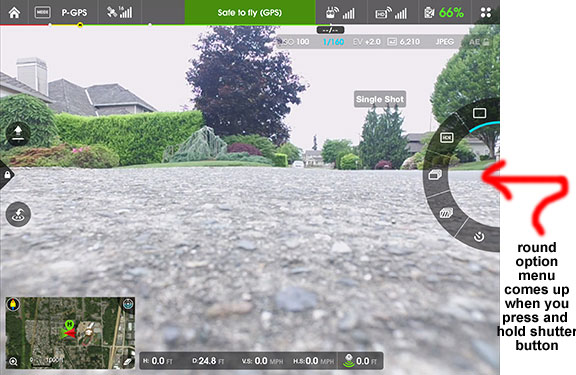

    One which is important is the various modes for photography like HDR, Bursts, bracketing, etc.
    This comes up in a circular menu when you press and hold the on-screen shutter button on the Camera screen in the DJI Pilot App.

  14. webman
    Important safety reminder - ALWAYS remove your propellers when you turn on your Phantom 3 inside or in any other place where you do not intend to fly!
    Properly learning the options in the DJI Pilot App requires some time and experimentation - this is best done with the Phantom and Remote turned on so that settings are live. Remove the props AND the gimbal clamp.
    Here is a picture of mine on the desk - as a bonus it's near some windows so it actually picks up a GPS signal in this location (so the Map in the DJI Pilot App is accurate!).

    DJI Pilot App - THIS POST CONTAINS MOST LINKS TO FUNCTIONS!
    A basic list of the functions of the DJI Pilot App which controls the settings, camera, etc. of the P3
    http://wiki.dji.com/en/index.php/Phantom_3_Professional-DJI_Pilot_App
    For tips and hints as to what all the functions of the DJI Pilot App are, turn on the Tutorial in the "Other" Setting screen of the App.
    Once you turn this on, the Screen will look like below:
    The bubbles will go away once you have touched the screen a few times - you can go back in an turn the Tutorial on again if you need them to pop up again.

    (you need to do this with the Phantom and remote powered on and your device connected, etc.)
    : : Upper Right --> OTHER --> Calibrate Map Coordinates (For China Mainland) OFF
    : : Upper Right --> OTHER --> Enable Amap (for China Mainland) OFF
    : : Upper Right --> OTHER --> Cache (Video) locally when recording OFF
    : : Upper Right --> OTHER --> Auto Clean up Video Cache (when over 2GB) ON
    : : Upper Right --> OTHER --> Clear Video Cache DO IT
    : : Upper Right --> OTHER --> Tutorial OFF

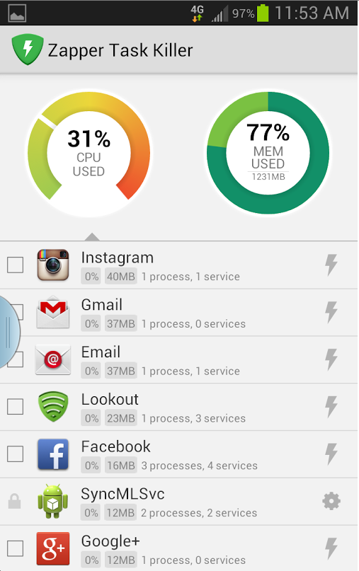

    Monitoring the CPU Load
    Download an app which allows you to monitor the load of the CPU - and also allows you to stop (kill) various running tasks. I use an app called Zapper Task Killer. As you can see below, it has a screen that shows the CPU and RAM use as well as a list of programs which are using some system resources.
    Open Zapper on your device and check the CPU use - before you open and use the DJI pilot app. Note the range of CPU use.
    Then, start up your Phantom and the Remote and the DJI Pilot App (if inside, don't put the props on) and wait until the Phantom has warmed up and is ready to fly. Start up the motors and take off and hover (if outside). Hit the video recording button (have it set on video) and then switch back in Android to the Zapper App and watch the CPU meter for a couple of seconds.
    (Zapper - click to enlarge)
    If it stays below 75% most of the time you are probably OK.
    You should not have video lag and if you do, something else may be causing it. Go into the setting for the HD stream and select a custom channel instead of auto - and turn down the image quality slider at the bottom to the lowest setting possible (4mbs). Try again.
    If that doesn't work then try the other tips below. If you are flying at a distance, make sure your antennas are facing the proper way for best reception.
    If it regularly peaks over 80-85%, read on.
    You have multiple programs hogging your CPU. First, try some manual settings to get rid of services that you don't need when flying your model (or at all). This means turning off wireless, cellular (if you have it) and bluetooth services. If your device has an airplane mode, that should turn them all off at the same time.
    Check your CPU and see if the percentage has gone down by a decent amount.
    In the Zapper Task Killer Screen, try the "select all" option and Kill them all. Don't worry, they will start up again either automatically or when you restart your device.
    Now, with the DJI Pilot App and Phantom running, try again. How is your CPU use? If it's down, then try a bit of flying and see if your video lag problem has improved or gone away.

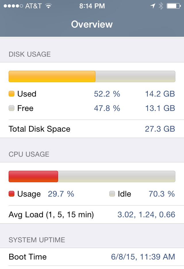

    You can download similar CPU monitoring apps for IOS. An example is System Status Lite:
