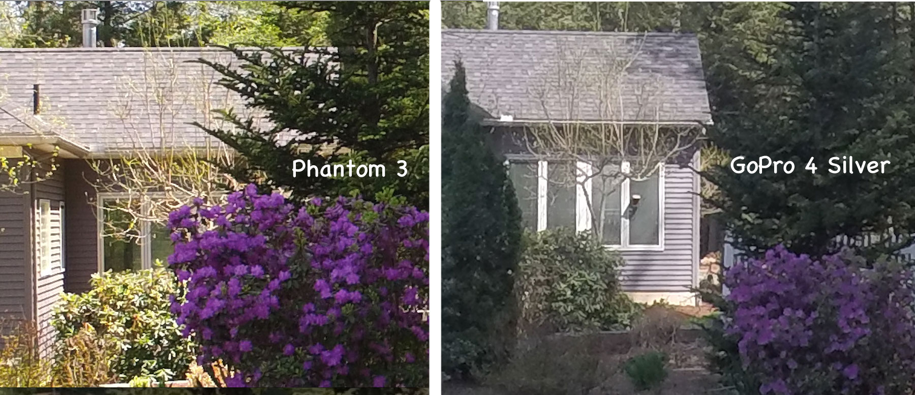

    One reader noted that perhaps the GoPro samples were affected by vibrations - my answer and samples below:
    There is certainly a difference in the stabilization - but most of the photos are flying very lows and in no wind. Also, the shutter speed of the GoPro is very fast and I took photos every 2 seconds and selected the best of them.
    Also, the GP in this test is very isolated from the main vibrations since it is hung off a plastic bottom protector (corrugated) and then off a rubber GoPro brand sticky mount, etc.
    Just to confirm that part I will take some of those same angles from the ground with the GoPro and test them.

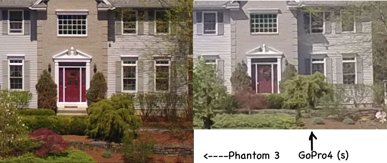

    So here are the photos taken with the GoPro from the ground - fully stable!
    Note - a couple hours have gone by so the light is a little different.
    Also, it's now a little unfair to the Phantom 3 - because we are comparing it's flying camera to a ground based model.
    I see a slight improvement in the GoPro detail from the same pic flying - however, the picture seems quite dull compared to the same Phantom screenshot.
    Another reader stated that the GoPro exposure could have been set differently - however, this test used both cameras in their stock and default modes...with the the GoPro it is not easy in terms of exposure and other settings changes, especially when flying on a quadcopter.
    Another point which should be mentioned is that the GoPro is taking a much wider shot - so having more real estate in the shot makes for fewer pixels in a similar sized object like the houses we are using for the example. Those who want a very wide field of view will prefer the GoPro - or will have to stitch together a panorama in the Phantom 3.
    Here is a comparison on one pic...click to enlarge.
    Here is a comparison of a bush and some shade and sun.
