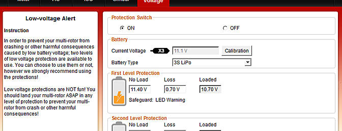

    Not sure about the 2 and 2+, but my old stock Phantom will descend and land at about 11.4 volts, which is about 3.8v per cell.
    Many NAZA (flight controller) users seem to disable or turn these down, preferring other timers or alarms or the on-screen telemetry to know when to land. It depends on your confidence and experience.

    Here is the DJI wiki on the voltage monitoring:
    http://wiki.dji.com/en/index.php/Naza-M_Voltage_Monitor
  8. webman
    Could be but my machine was very light weight at the time - I think it was Mobius onboard.
    The 2's are quite heavy due to the large battery. When my stock Phantom is flying my heavier cameras, it acts more like you describe - i.e. drops much quicker.
    I'm going to try turning the voltage warnings down a little lower and see what happens. I suspect that it will work fine with light loads (slow on the sticks and throttle and less weight), but that it will act up when more loads are pressed upon it.

    I can confirm that the P2+ can act really strange at under 30% battery!
    This is a result of the intentional programming - it can probably be slightly modified in the DJI Assistant, but doing so may endanger your craft. There is a good reason for the warning and low voltage settings.
    Today I was up at about 200 feet taking some pics - and the battery was about 30%. I had the sound very low on my phone, so I didn't hear the warning start - but I did know the % and started to bring the quad down. At about 25% battery, the quad started falling FAST - obviously it's internal programming saying it would be wise to get near to the ground. It would not respond well to stick input telling it not to drop quickly. I thought it was crash time - although it was not falling like a rock. It was falling fast enough to hurt it if it contacted the ground.
    At about 30 feet above ground it stabilized itself and continued toward the ground and actually bounced off the grass - then I was able to get some control although the craft was obviously telling me it wanted to be near the ground.
    All this is as it probably should be....to some degree...as default settings. But it's certain scary watching it fall quickly.
