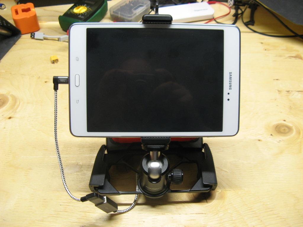

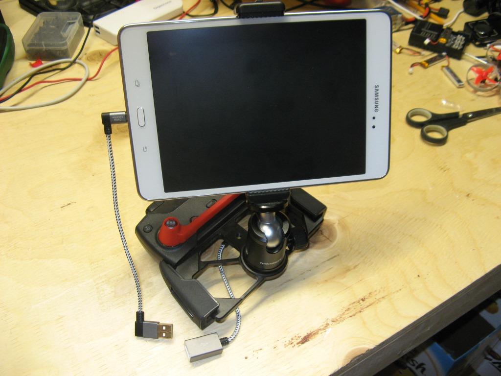

    A picture is worth a thousand words, here's how it's connected. OTG cable plugs in to controller, then cable goes from OTG to tablet
