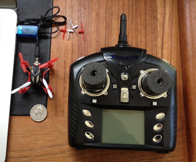

    Included in the RTF package are the quad, the TX, a USB charger and one set of spare props.
    The quadcopter itself is another miracle in engineering - very tiny, yet with all the systems of a larger quadcopter. The battery is built-in, but at the same time it uses a common connector so that hobbyists can rig up additional batteries if desired.

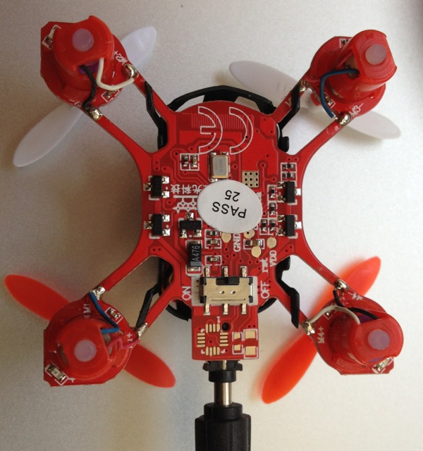

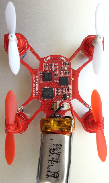

    (top - with battery moved out of the way)
    (bottom - pic with QC sticker).
