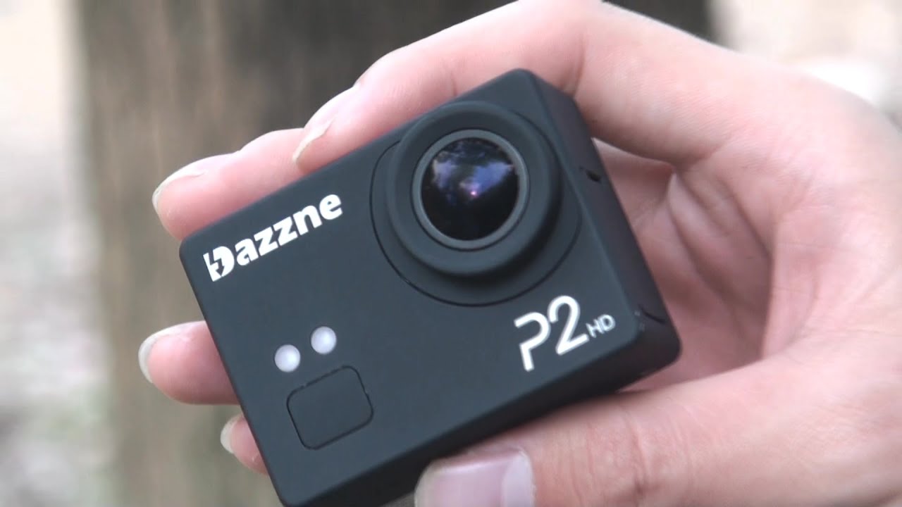

  5. RGJameson
    My Dazzne camera comes in at ~95 grams naked. Those waterproof cases add a lot of weight, best to not use them.
    A lot of folks use Walkera gimbals. They claim 120 grams.
