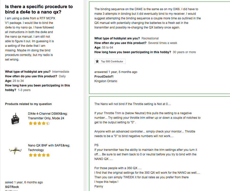

    Newbie here. So I got my 350 qx and a nano. The 350 came with Spectrum dx4 . I've been looking for video or instruction on how to bind the nano to the dx4 but so far no luck. Can anybody direct me to a video or instructions on how to do this? The manual isn't much help. Thanks in advance!
    These are on the Horizon QA page - it looks like you need to try a couple times, have the throttle at absolute zero, etc.
