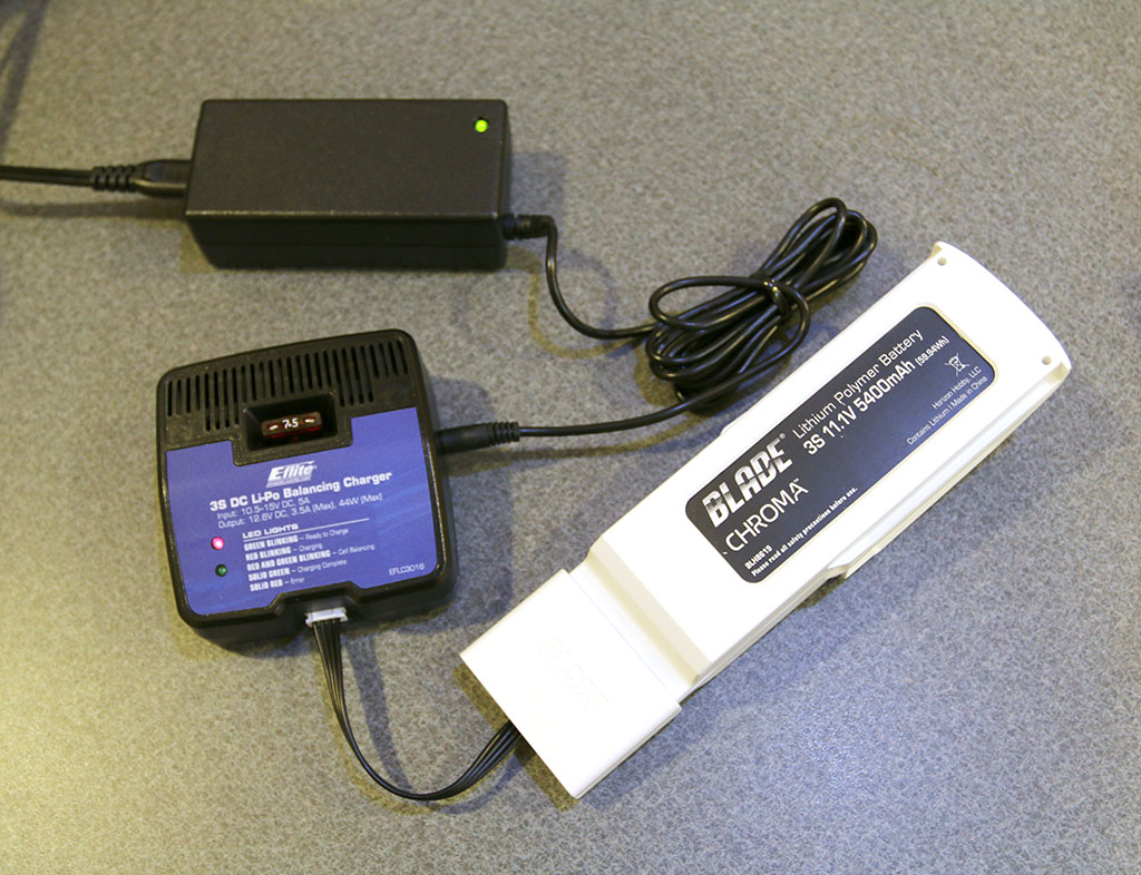

    I have a battery for Blade Chroma that I am quite sure is no where near the end of its life. I last used it maybe 3 - 4 months ago and definitely did not push the limits on discharging it. It no longer responds when plugged in to the stock charger. The status lights act as if I did not connect the battery. Any ideas on how I might revive the battery and test it?
    Thanks in advance
    Is this your charger?
    If so, pull the white balance plug out of the charger. Using a multimeter (or a LiPo alarm) You'll then be able to check each individual cell. You want them close.
    This guy needs a new charger. :) That said you may just have one cell that is below your charger's threshold. If you are handy there are ways to charge the cells individually.

    This is my charger. The second battery charges fine. I might take it to local Yuneec shop to see if they will help me test the battery.
