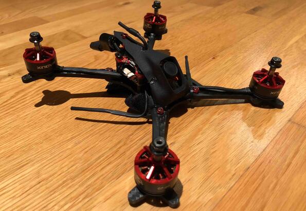

    One of the favourites of my friend fleet. This is an upgrade of his first Floss build. Maiden to be done, looking forward to see how fast it can be!
    Hyperlite Floss V1 Setup:
    • Furious FPV Fortini OSD
    • Hobbywing 4in1 ESC 40A
    • Xnova 2207-2600KV
    • Runcam Micro Swift 2
    • Emax Magnum VTX
    • TBS Linear Antenna
    Will be maiden with DAL 5050 2-Blade Props and Tattu R-Line Version2.0 1550mAh HV battery, hopefully soon!
    Part List:
    Frame - Hyperlite FLOSS 5 inch Racing Frame
    Flight Controller - FORTINI F4 OSD 32Khz Flight Controller SKU: FPV-FORTOSD
    ESCs - Hobbywing XRotor Micro 40A 4in1
    Motors - XNOVA Lightning 2207 2450Kv
    Propellers - DAL 5x5 - 2 Blade, Blue Cyclone Propeller - 5050C (Set of 4)
    FPV Camera - MicroSwift-OR-L21 - Micro Swift w/ 2.1 Lens - RunCam
    FPV Transmitter - F4 Magnum Tower parts - VTX Board
    Antenna - TBS UNIFY PRO 5G8 Linear Antenna
    Receiver- Flysky X6B 2.4G 6CH i-BUS PPM PWM Receiver for AFHDS i10 i6s i6 i6x i4x
    Batteries - Tattu R-Line 2.0 4S 1550 mAh 100C HV Lipo Battery
