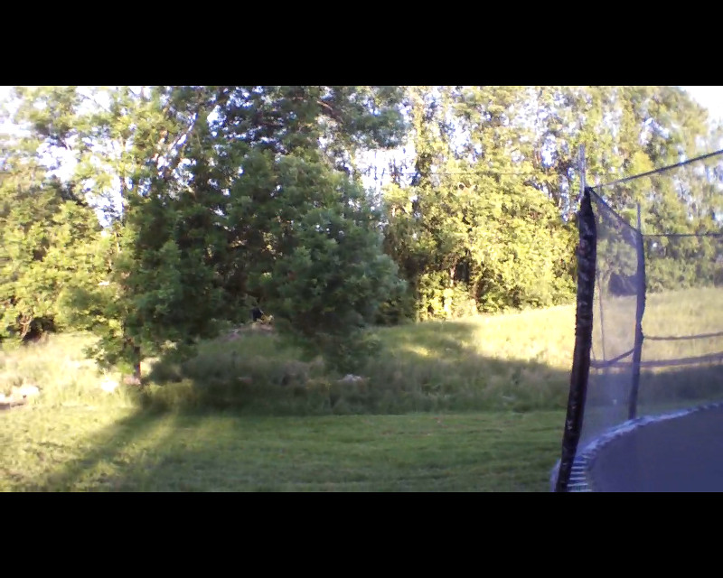

    I am not sure its wifi interference, and I think this because it has no noise when the battery is full, and it gets progressively worse as the battery becomes depleted. Plus the distance between the drone or the phone doesnt alter it and I'm recording to onboard memory, not the remote phone, also the only wifi in the area is mine, and this is away from where the signal strength is strong. Where I live its very very isolated and rural out in the countryside.
    Take a look, this is at the start of the last flight video, I'm stood maybe 30ft away but this is being recorded to the flight controller card so its not noise on the wifi link but between the camera and main board, and I suspect on the dc rail that powers everything. Its the same with or without the flight controller as I tested without in case it was that.

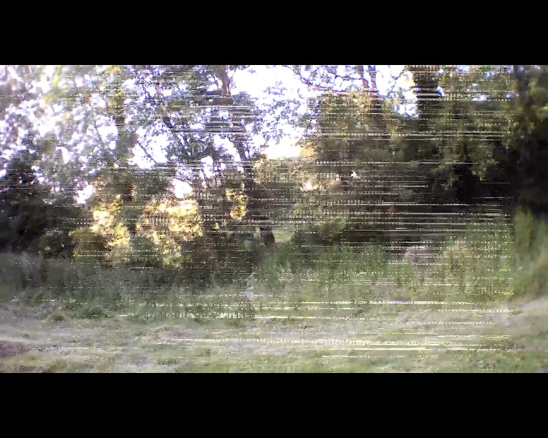

    And here it is with the battery about 40%. I'm stood nearer, and it actually gets a lot worse than this but it gets so uncontrollable I cut short the flight to stop further damage.
    Not sure what the ecs is, but suspect its the embedded processor board that runs the drone. The idea behind sending it back to parrot is that its 6 months old and under waranty, and the board itself is 120e to replace.

    Only other thing I can think of is poor connections, try unplugging and then reconnecting every connector (one at a time). The picture tells me it has to do with electronic noise and probably due to the motors high current draw with lower voltage available.
    You can also try to move the motor wires further away from the main boards.
